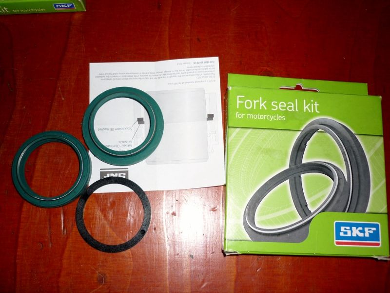

Seals and oil arrived. On advice of a suspension specialist not the Ohlins seal but SKF.
These should be better than the Ohlins. Also low friction and better sealing. Two springs in one seal.
It’s a complete set, oil seal, dust seal and retainer.
I like the green color it will suits the bike well..

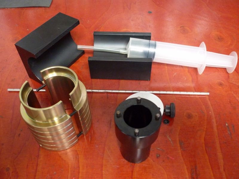

Cool stuff! What did you use to disassemble the fork legs? Pics of tools are needed!! _________________ Spike C.
1965 Triumph T100SC |
Posted: Sat Jul 04, 2015 7:46 pm Post subject: |
But of course Spike, photo on request.
I was lucky that I could borrow this set from a friend.
 _________________ vince
Posted: Sun Jul 05, 2015 3:09 am Post subject: |
Thanks Vince! very informative. I could make the stanchion holders out of hardwood. Determining the the spacing of the pins on the other tool will take a bit of research I suspect! _________________ Spike C.
Posted: Sun Jul 05, 2015 9:53 am Post subject: |
I'm also going to make a set for myself. You never know if I have to do this again in the future. I make some drawings of the tools and as soon as I have some free time I will make my own set.
For the endcap you can use a pin spanner wrench, see picture.
