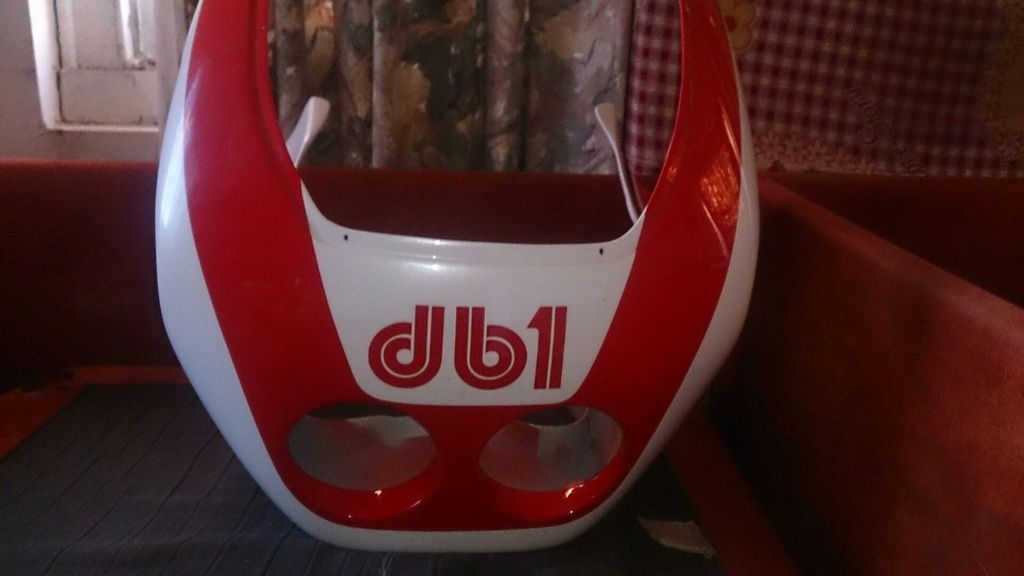

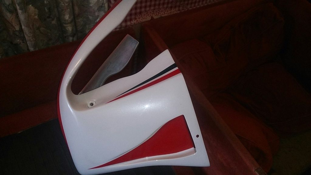

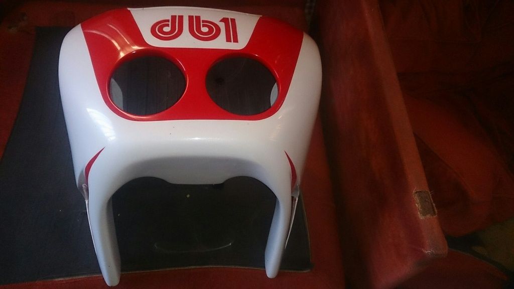

here are images of that fairing nose I mentioned. I acquired it from some guys who had raced one here, I had a good friend of mine (now sadly deceased) make it up as you see it, including paint (I gave him a free hand, he was a brilliant painter). As stated, I saw a pic in some book years ago of a DB1 racing in a 24 hours event. Those large red areas are extra vents.
and obviously I have mastered this posting photos thingy, yay!!!

That twin headlight fairing looks beautifully made - nice work! Looks good enough to be a factory item. Do you have the lights and mounting etc to make it work?

yes, I have a set of lights, spare mirrors and a spare screen to fit. I will have to acquire the actual branched wiring, or try to make something up myself. It actually looked quite good on the race bike, actually better than the square headlight.
