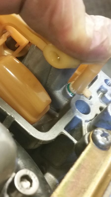

Posted: Sat Mar 18, 2017 5:38 pm Post subject: |
Here's my little problem. The old seal on the floats had shrunk and the carbs floated. The new ones don't squash into the hole (technical innit) so it looks like this, the floats haven't located. The new seal is green.
The carbs don't flood but the bike pops if I throttle off
Suggestions ? _________________ Don't read everything you believe |

Posted: Sat Mar 18, 2017 6:46 pm Post subject: |
Mine were tight to go in. I pushed until I felt resistance to pull them out. The innuendos possible here are plentiful! ! |
Posted: Sun Mar 19, 2017 9:53 am Post subject: |
Mine won't locate and mess with the float height _________________ Don't read everything you believe |

Posted: Sun Mar 19, 2017 10:22 am Post subject: |
Could you try swapping them around to see if others fit better in other holes or is that not advisable? If you are setting float heights anyway surely it wont matter. I take it your seal kit came from Thailand too? Worth ordering another set to see if its any different? |
