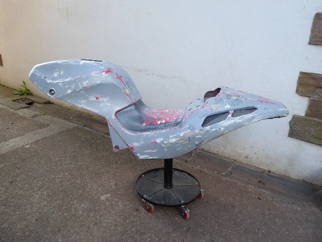

In any case, in between other jobs the seat unit was stripped down. After much scraping/filling/sanding, inspection.... repeat , repeat again it sort of looks like this,
Actually it looks a bit better than this now as these photos were taken after 'round one'. You can see the original DB400J paint scheme showing through in places. before it got the grey and silver 'hot-rod flames' treatment.
In for a penny in for a pound I removed the mesh 'vents' at the rear so that any paint/wrap can be done properly. These had been installed with a total lack of care but copious (if uneven) amounts of filler. Out of sight out of mind I guess!
Dremel to the rescue to weaken the bond enough to remove the mesh which I will be able to use as a template for replacement.
pic hosting
I'm now just waiting for some weather to allow a primer coat outside to see how it looks, but after several days in mid 20's and blue skies, yesterday and today are showers and very blustery.. Heh ho!; plenty to get on with (Including replacing a ridge tile that came off in the wind!) and theres the seat and bumstop to look at  _________________ Not as many bikes as I would like and already too many to keep up with!

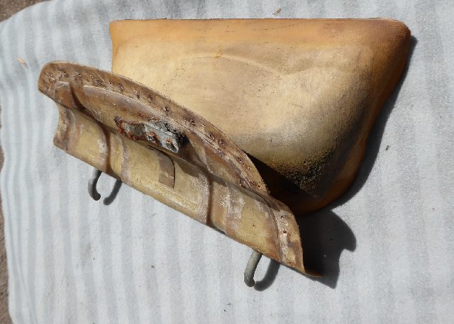

Well........ The bum stop and seat always were going to be stripped for recovering, so let the fun begin!
Easing the vinyl cover off the bum stop first (the staples had long since rusted and 99% of the attachment was now the glue) it was good to see that the fibre glass base was reasuringly thin (1-2mm) and light and the moulded foam good enough to reuse no problems.
Fittings are a bit corroded but should clean up. The 'rough arse' finish on the fibreglass does look a bit out of place though so might get a (very!)light sand and coat or two of laquer before it gets put back together.
The seat unit was another matter though! .
I had noticed when weighing bits and pieces that the bum stop weighed 380g but the main seat a whopping 1430g.
As soon as I got the vinyl off I could see why that was... the foam was sodden with water. The vinyl had two small punctures in it (maybe 1.5mm each) but must have been letting in water for a long time. It looked and felt horrible.
The foam is currently next to the hot water tank draining and drying out. I will leave it for a few days but even after 24hrs I can feel a big difference in weight. I'm hoping that the foam looks worse than it is and I should be able to replace the glued on anchor plate that allows bolting to the main tank/seat unit. Fingers crossed _________________ Not as many bikes as I would like and already too many to keep up with! |

| Coming along slowly but then Rome wasn't built in a day.....and "past the worst" which is when restoring you have to strip back and it looks far worse than when you started......Wickes do a good line in varying Mesh grilles in small panels....Personally....although I understand your reasoning....I wouldn't have removed the mesh.....It is....undeniably....an absolute pig to reaffix.....even if with new glue...new mesh.....as the mesh and fibreglass just dont seem to want to go together.....trying to bend the mesh so it sits flat.....then "what type of glue"....or 2-pack epoxy......and the darn mesh just wants to peel off and come loose every single time...and its a pig to find how to clamp them during the glue going off...and glue or epoxy dripping round onto new paint etc etc....I fitted a piece on the supercity that was missing...has to be one of the most frustrating tasks I've ever attempted.....comes way higher than siliconing around a bath....or removing the old silicone...etc etc....Much swearing was had....what a Nightmare.....You will surely turn the Welsh Air Blue.....just tell the Mrs to go shopping for 24hrs...as she will think youre whipping up a murderous holocaust in your man cave if shes in ear shot.....I can "imagine" that the proper way is bonding it in with wet layers of fibreglass....but I had none...Skip Clear colourless tank sealant also...that does nothing....2=pack epoxy...>Nope......2-pack araldite....nope neither...gel Superglue...Nope...Bostick...nope again.....I was tempted to rivet or bolt them in with form D washers buy the time I finished..... |
hindsight
Joined: 13 Feb 2010 Posts: 130 Location: Central Scotland
Posted: Sat May 23, 2020 7:24 pm Post subject: |
| I feel your pain Steve - I've had good results gluing that kind of mesh with a hot glue gun. |
