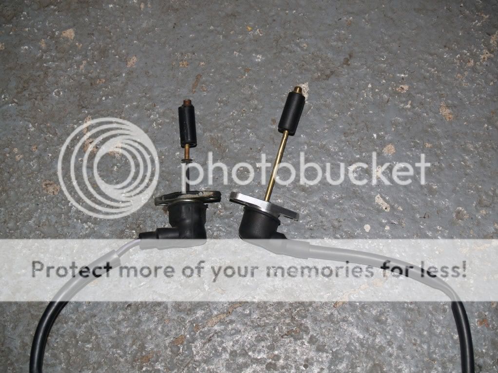

And here we are...........
SB6 on the left and Vdue on the right Wink
Anyone recognise them from another bike perhaps ?

I have the tanks off both the sb6 and db4 at the moment so i removed both senders to compare them. They both look basically the same (same as in oily's pics above). The sb6 sender tube is 60mm long and the db4 tube is 135mm long. I have no idea how the thing works or what stops them working! Both of mine seem to flicker with engine revs. I'll probably just disconnect them when they become too eratic.

They work by having a reed switch in the tube, which is the bit that brakes and a magnet in the float to open/close the reed switch.
If I can figure a way to get them apart, fixing them should not be too difficult Wink

Exactly. And look what I found recently! It looks exavtly like the one I bought from bimota for the SB6 (bimota part no 215000778).
The plug looks like the one on the V-due though.
http://paioliammortizzatori.multimodo.com/prodotti/img/Upl-11-1-009.pdf
It seems that it is a Paioli item.
