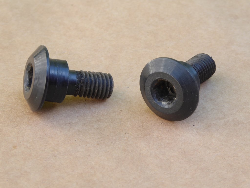

The seat bolts delivered to coaters yesterday. The last two weeks he has had a family death, one staff member at his main business left, one was sacked and he got an infection and is on antibiotics. Cutting some slack seems appropriate.
Should get them back within a week. Note that the thread major diameter has been cut at mid tolerance to DIN spec. The plastic ones I measured were just about below min diameter . If the thread is a little tight on insertion on your bike I suggest tapping out the frame thread (M10 X 1.5). To clear out any accumulated crud.

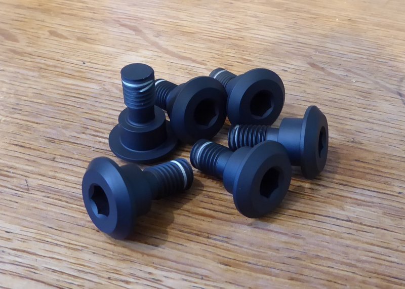

we started with this
Then made these
and finally we have arrived at this!!
Just got these back this afternoon from the Cerakoters and wanted to reassure folks.. [photo now updated 25th to show true colour..stand easy troops! the white line is where they wind a wire around to hang them for spraying]
Will be contacting everyone with payment details and get them on their way to folks over the next few days. Got there in the end!
