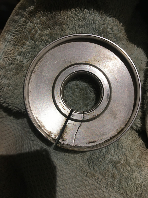

This time I decided to give it a good look over to check it would go through the MOT with no issues, forks seem to have too much play so I took the top yoke off and found a split nut , any ideas where to get one or if there is another bike with the same threads l.

Many of the early Bimotas used the same threaded collar. Centrepoint wholesale in Australia has a few of them for sale on eBay.

Search on bimota-parts.de its in English and German...rudolf has had them remanufactured....its a milled from billet bimota specific piece....often the clamping bolt is over tightened causing that split.... https://www.bimota-parts.de/en/component/virtuemart/yb9/lenkkopfrohrmutter-detail.html?Itemid=470

Thank you for the offer, very much appreciated however I have ordered one from Rudolf in Germany, a bit steep at €93 inc shipping + import duties but needs must.

Good news. As 2bims says above...... don’t over tighten it.

The saga continues, the new ( expensive ) part I bought is incorrect on the outer diameter, too small to go over the frame and clamps on the frame. I could fit washers onto the head bearing but that would allow dirt into the bearing ????

Post the dimensions of your broken nut and I’ll see if I can help you out
