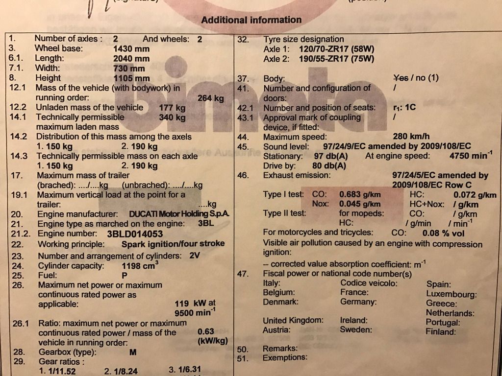

mb_pfalz
Joined: 24 Feb 2016
Posts: 22
Location: Germany
PostPosted: Wed Feb 15, 2017 8:19 pm    Post subject: Reply with quote
hi
i am not shure if you need a document or a sign on the bike
maybe this can help, position 42.1 from an original EC. Certificate of Conformity (date 30/07/2013) db8 italia
